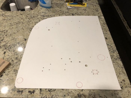

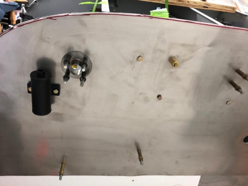

Short Description:  FiberFrax fitting
I used the Titanium sheets to trim the FiberFrax and also marked the holes. I then used punches to  make the holes. It only required slight hand pressure to push through the material.
The large holes were cut out using a sharp knife.
FiberFrax trimming and punching

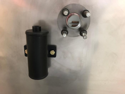

FiberFrax and Titanium on FW
Cutting out cable penetrations
