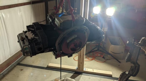

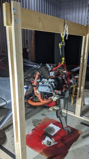

My oil leaks were getting larger. Really only one place it could all be coming from (after looking at everything else): rear oil seal. So I spent a couple of hours disconnecting things, then had my friend Max help me take the engine off and replace the seal. It took me a few hours to reconnect everything.

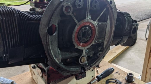

You can see in the photos that I left the accessory plate attached to the engine mount, and instead just removed the engine from the accessory plate. There's much less to disconnect and reconnect that way.

About to unbolt the engine
Just hangin' out!
New oil seal in place
