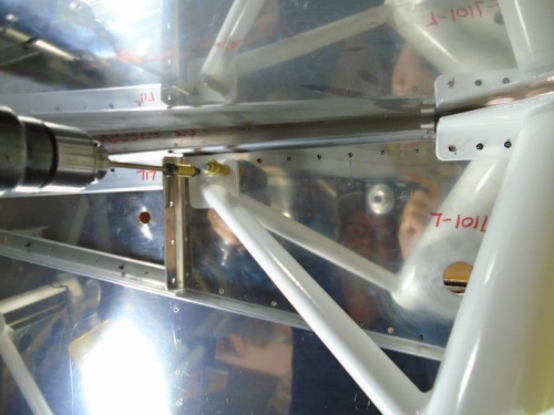

Short Description:  Baggage floor drill, debur, and dimple
I took the vinyl wrap off the baggage panels (3) an smoothed our the edges. Fitted and drilled all the holes with the side baggage panels in place. Seems like a lot of this could have done (e.g. drilling and nutplates) prior to all of the assembly, but hey I guess i am just following the plans.
Deburing and dimpleing were next. Parts are ready for priming next.

Reach in and drill
