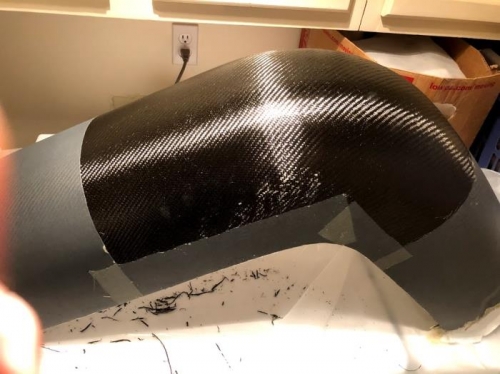

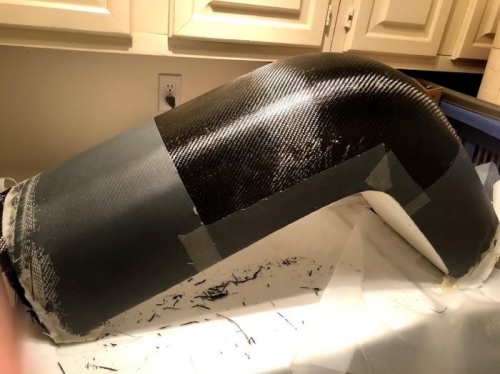

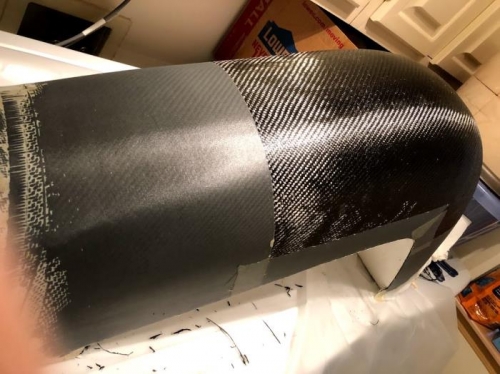

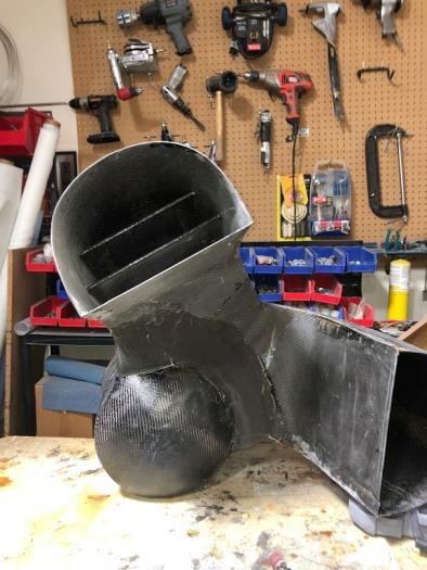

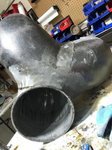

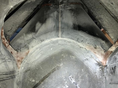

Date: 01-26-2019
Number of Hours: 10.00
Short Description: Glassing pieces together
spent several days sanding everything and bonding the intake together. I used Flox to fill any gaps or voids and then 2 Plys of CF BID... I also used X30 expanding foam to create a nice ramp transition where the intake runners merge into the diffuser.
