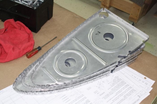

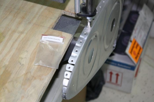

Short Description:  Cleaned Proseal from R-Tank Ribs

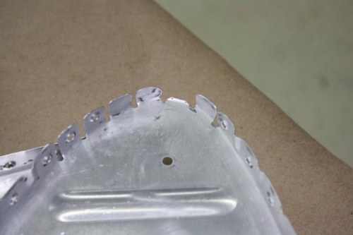

No Step: Soaked ribs two at a time again in MEK which softened the Proseal but did not melt it off. Still had to scrape and scratch off with a small wire brush and Scotch-brite. Came out clean and no apparent damage. All five done. Had some minor damage to one where LE radius tab broke off. This was not so much rough handling when removing as it was a result from buffing the edges to remove sharpness. In the process, the radius of the tab was ground down too thin and the action of cleaning it cracked and broke it off. I'll deal with it.
Missing a tooth.
Re-dimpled to pull back into shape from over bucking upper surface rivets
Done cleaning and marked for Right Tank (again)!
