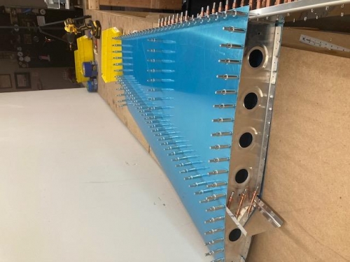

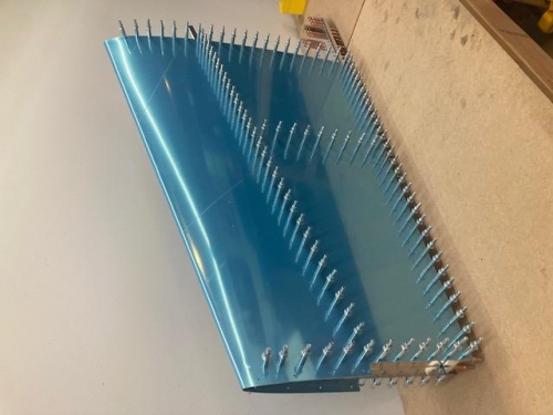

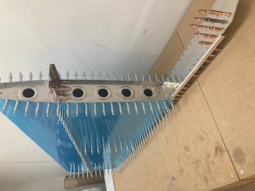

Clecoed on the VS-801PP Vertical Stabilizer Skin. After that was in place took care of match drilling all the holes to #40 as per the plans. The next operation will have us dissasembling the whole structure and preparing the parts for prime and final riveting/assembly. There is alot to do with countersinking (some holes), dimpling operations and lots of deburring holes and edges. I have my work cut out for me for sure.
