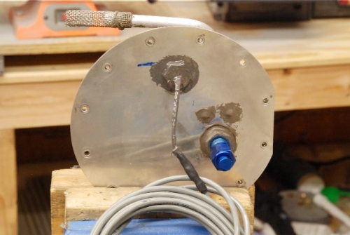

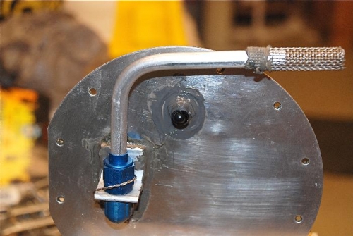

Brief Description:  Prosealed the sensor to the rght tank access plate
Prosealed the sensor to the rght tank access plate. To prevent the proseal from getting on the sensor, I put some tape over the optical sensor. This succeeded at keeping the sensor free of proseal but the sensor surface appeared slightly hazy even after gentle wiping. I won't use the tape again for the left tank installation.
