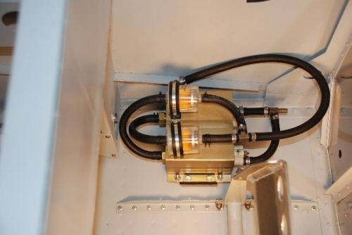

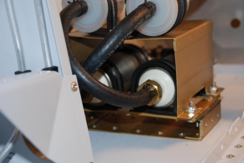

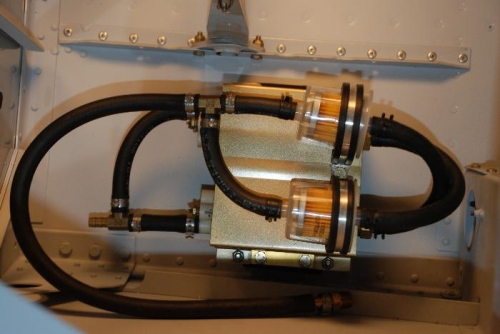

Mounted the fuel pumps
Mounted the fuel pumps using AN3-5A bolts torqued to 25 in. lbs. A piece of rubber with adhesive on one side was placed between the pump bracket and the pump mount for additional vibration isolation.
View from right side
Top view - Front to the left
Rear view
