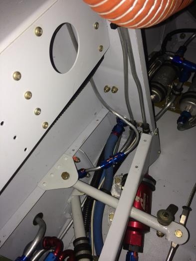

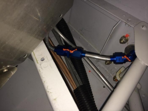

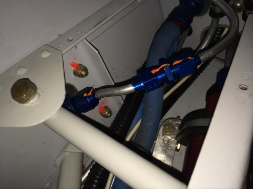

Brief Description:  Repaired the Vent Lines at the Fuselage Bulkhead
Repaired the Vent Lines at the Fuselage Bulkhead inside the cockpit. I cut the lines to remove the twisted vent line at the bulkhead AN fitting. The remaining end of the vent line was flaired. A short piece of 1/4" tubing was flaired on both ends and used as the replacement from the bulkhead fitting to the remains of the native vent line. A -4 union was used between the vent line flairs.
Right Vent Line Repaired

Left Vent Line Repaired
