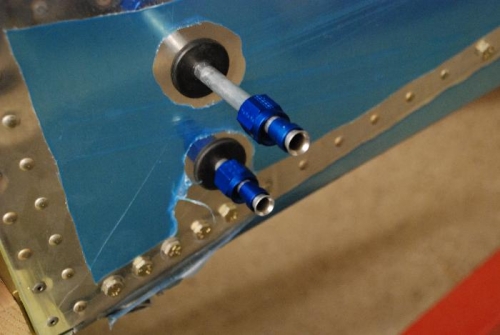

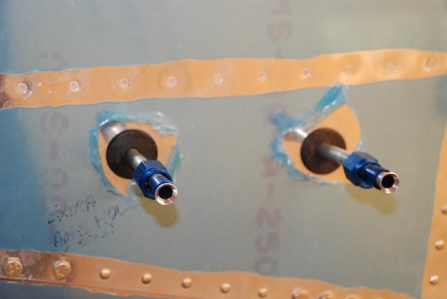

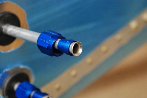

Brief Description:  Put AN-6D fittings on fuselage fuel line terminati
Put AN-6D fittings on fuselage fuel line terminations that will connect to the wing. I had to free up the right tank supply line so that it could be extended on the exterior of the fuselage. This had to be done in order to be able to flare the line for the AN-6D fitting. I had wondered how olng the fuel lines should be outside the fuselage. I happened across a drawing reference that said that the lines should be cut off at 3.5 inches. The supply line from the right was 2-2.5" at the cut when I installed it. All of the other lines were at least 3.5". I did re-make the left side return line because it had a kink in the bend.
Left tank fuel lines

Right tank fuel lines

Flared line and AN-6D fitting
