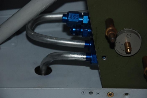

Installed Left tank return after several attempts. I used a Unibit to open a 1" hole in the left side for the return line. The first line bend worked out perfectly until I realized that I had measured from the supply elbow, instead of the return elbow, to the location of the return line hole. This meant that I had to work harder to get the bends that I needed to the get the new return line to transition to the exit hole in a short distance.

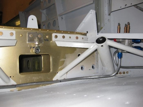

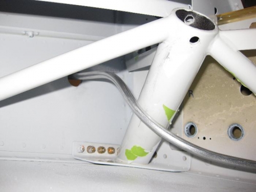

Bent the right tank supply line. Lots of trial and error but it is getting better. The line is roughly fit. It needs to be secured. Next, I need to bend a twin line for the return line.
Left Tank return line exiting
Right Tank Supply line + valve
Right Tank Supply line exiting
