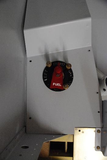

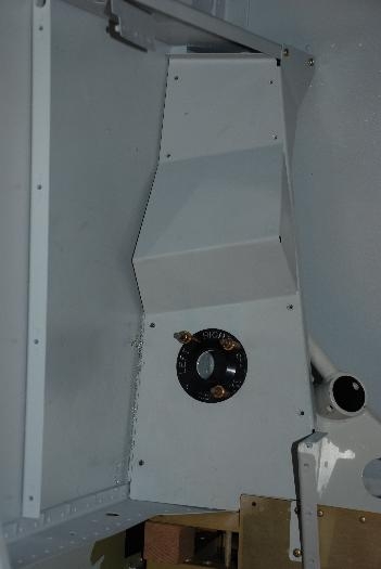

Date:  1-1-2009
Number of Hours:  4.00
Brief Description:  Finished Installation of the Andair valve
Finished Installation of the Andair valve by cutting a matching 1.25" hole in the F-8113 Mid Cabin Cover Assembly to accommodate the neck of the valve. I surprised myself by how well the valve mounting bracket hole and the cover hole lined up. I then match drilled the mounting bolt holes using the mounting bracket holes and the valve cover holes.
