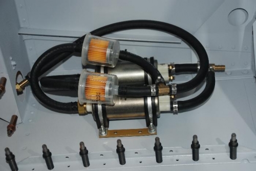

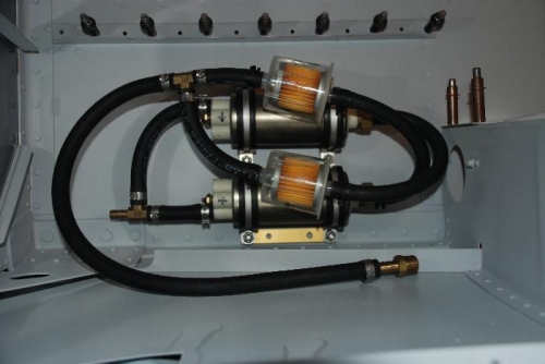

Brief Description:  Re-assembled the fuel pump setup
Re-assembled the fuel pump setup after I bought some 5/16" I.D. fuel injection hose. The low pressure side filters will sit on top of the pumps. This will allow me to set the pumps up in the front left corner of the fuselage in an assemble package that will have a small foot print. Doing this decreases the complexity of fuel runs within the cabin as well as the number of parts. I plan on making a cover for the pumps on which to mount the filters. The cover will be loose to offer some protection to the pumps without hingering their cooling.
Pumps in cabin front left corner
Top view - firewall is to the left
