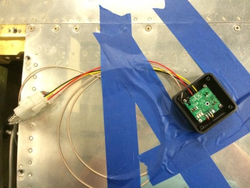

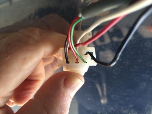

Brief Description:  Installed Princeton Fuel Senders on Both Tanks
Installed Princeton Fuel Senders on Both Tanks. Discovered a varnish partially clogging the left tank drain when we were going to start to fill the tank. Pulled the tank cover and scoped the tank. The tank was clean except for the aft inboard corner where there was a small colllection of varnish around the drain. This was removed and the cover replaced. Filled the tanks and calibrated a dip stick during the process. Tank fuel levels still read about 2 gallons. Need to talk to GRT/EIS for answers. May be a offset that needs to be set in the EIS.
