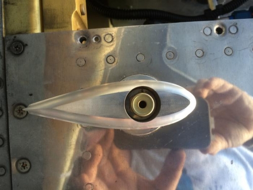

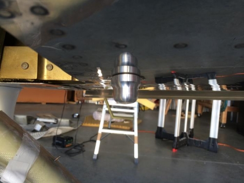

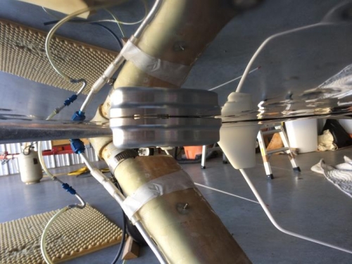

Brief Description:  Installed the Fuel Tank Drain Fairings
Installed the Fuel Tank Drain Fairings after replacing the drains with drains that have Vition O-rings installed on them. These o-rings better withstand ex[posure to the ethanol added to auto fuels.
Bottom view
Bottom view
Looking Inboard
Looking Inboard
Looking Aft
Looking Aft
