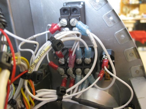

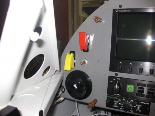

Installed Main Fuel Pump Disconnect Switch. I didn't like not being to isolate the main fuel pump. Being an essential piece of equipment, the wiring schematic has the main fuel pump powered directly from the batteries with a complete redundancy of a main and a secondarycircuit for the Ignition, ECU, Fuel Pump and the Prop. The Primary and Secondary Circuit is controlled by a switch located next to the newly installed Main Fuel Pump Disconnect. Now if there is a reason to secure the main fuel pump, I can do so with the new switch. I still have another backup pump, called the Boost Pump. that can handle the fuel pumping duties.
Yellow Covered Pump Switch
New switch on Right
New switch on Right
