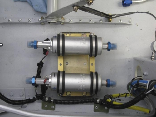

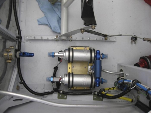

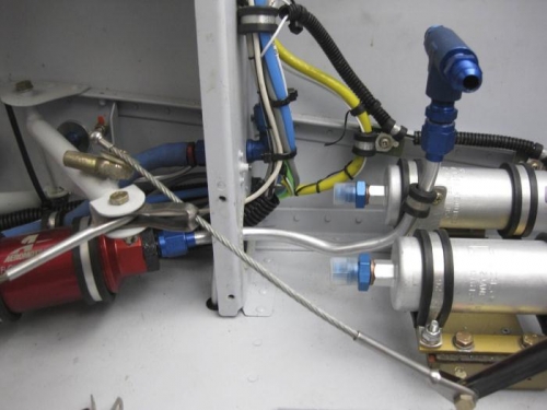

Brief Description:  Installed the New Walbro Fuel Pumps
Installed the New Walbro Fuel Pumps. Installed a new t-piece at the firewall pass-through fittting. One end is an NPT Thread for the filter and the other two connections are AN-6D. Contacted Bonaco Lines and Fittings for flex hoses for the supply side of the pumps because of the confined space and the need for short hoses with right angle fittings. I can't make the angles with my bending equipment and skills.
