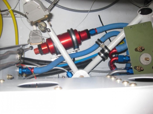

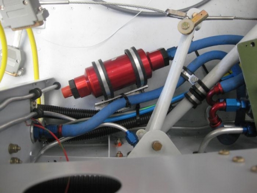

Brief Description:  Attached Fuel Return Line to F-802A-L Fitting

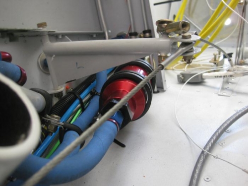

Attached Fuel Return Line to F-802A-L Fitting on the aft side. A straight Aeroquip push-on fitting was fitted to the return hose coming from the fuel selector. Fuel Lube was applied to the bulkhead fitting threads prior to connection. A zip tie was used to draw the hose toward the floor to insure clearance from the rear pedal sping arm. The adel clamps that were used to secure the return hose to the landing gear weldment was tightened in position.
F-802A-L Bulkhead Connection
Zip Tied Hose to Mount Angle
View of Clearances
View of Clearances
