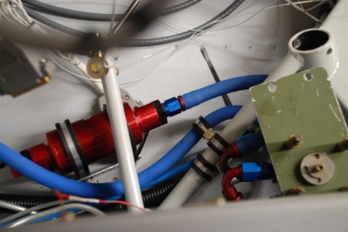

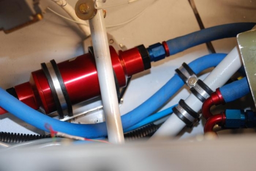

Brief Description:  Installed the 100 Micron Fuel Filter
Installed the 100 Micron Fuel Filter. To do this, I had to remove most of the structures around the fuel selector valve and eventually the valve also. The filter is installed on the step off of the floor. Here the floor angles down towards the center spar. Therefore the mount needed to be riveted to the floor prior to the drop-off and at the same time not interfere with the movement of the rear rudder pedal movements. Eventually, I was able to satisfy both of these needs and the mounting bracket for the filter was riveted to the floor with four LP4-4 rivets.
