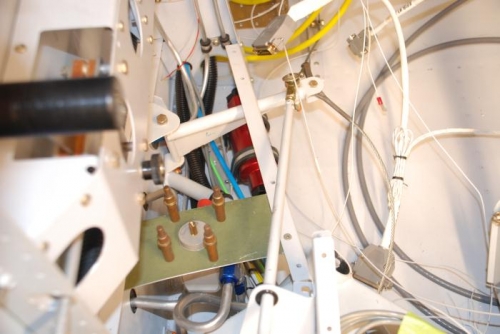

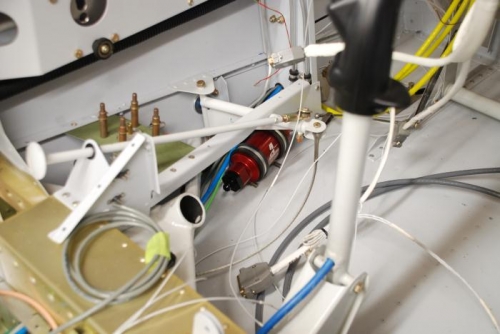

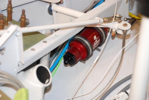

Brief Description:  Fabricated 100 Micron Fuel Filter Bracket
Fabricated 100 Micron Fuel Filter Bracket and placed it in the aircraft to plan its location for riveting. I have to find the right location where it will be readily accessible for maintenance and yet not hinder flight control movements. I'll have to disassemble some left lower panel structures for better access to rivet the filter mounting bracket to the floor.
Planned Location Lt Side
Free of Rudder Pedal Movement
Mount Outboard of Filter
