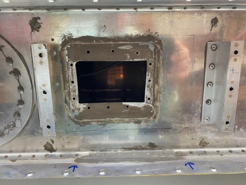

Repaired a Leaks in the Leftt Tank 3rd Bay.
I enlarged the opening to make the repair easier. I started my cut too far inboard to easily fit the rivets of the opening cover plate. I angled the cut outboard to have better rivet placements.
Old Plate Removed
Old Plate Removed

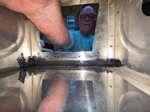

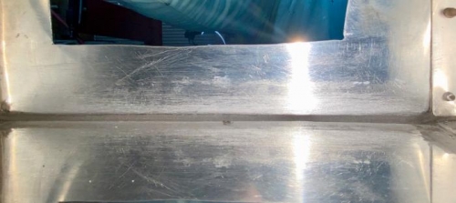

Old sealant removed
Old sealant removed
Sealant applied
Sealant applied
