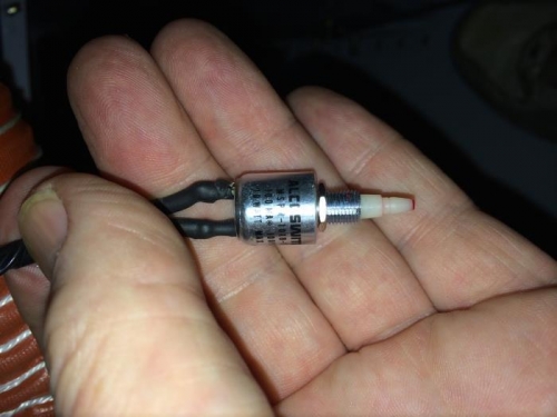

Brief Description:  Wrong Switch for VoiceFlight System
Wrong Switch for VoiceFlight System. Discovered during a software update that the VoiceFlight System was not responding to a double click input often used to confirm an action. As it turns out, the installed button switch was not the correct one. The installed switch was a normally closed switch instead of normally open switch. A replacement switch has been ordered.
