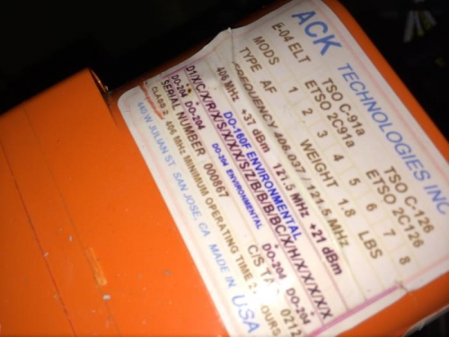

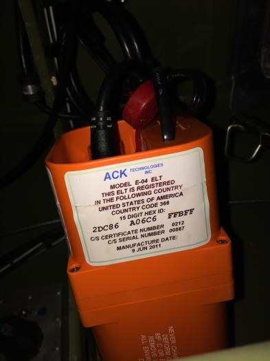

Brief Description:  Checked ELT For Expiration Data

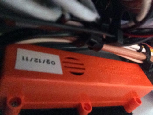

Checked ELT For Expiration Data. The ELT battery is goods for 5 years before needing replacement. The manufacture date is 09 JUN 2011 so the expiration date is 09 JUN 2016. This information has been entered into the aircraft logbook. The battery for the panel mounted ELT Remote is good for 10 years. Installed 09/12/2011, it will expire on 09/12/2021.
