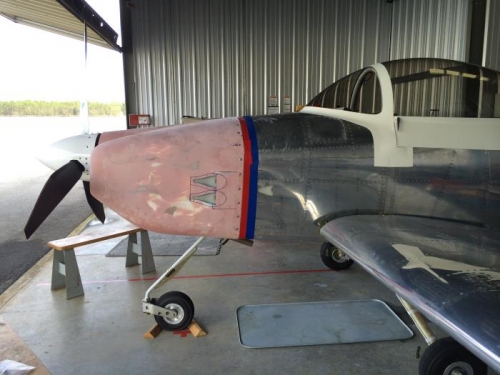

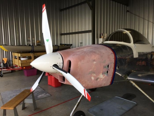

Brief Description:  Fit the Cowl Flap/Adjusted Flap Linkages

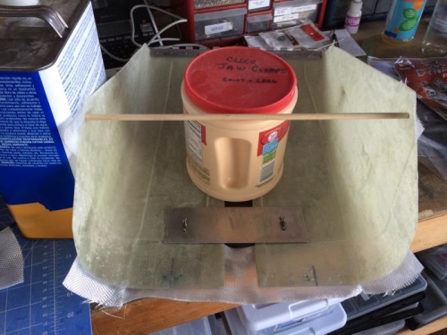

Fit the Cowl Flap/Adjusted Flap Linkages to get the flap to clear the exhaust pipes. The interior surface of the flap will need some heat shield applied to protect it from the heat of the pipes when retracted. The fit is fairly good. Applied some fiberglass strips to the inside of the flap to shape and stiffen the sides.
The range of motion of the cowl flap and the motor function are both good.
Flap Stiffening
Flap Stiffening
