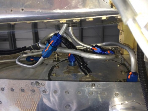

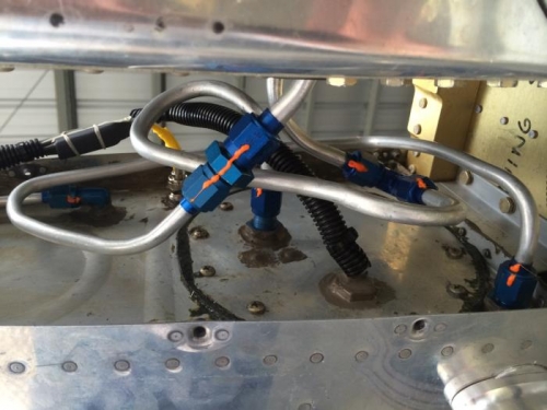

Installed Lines Between Right Tank and Fuselage. Top line through the fuselage is the supply line and the bottom is the return line. The supply line is 3/8" tubing and the return is 5/16" tubing.
