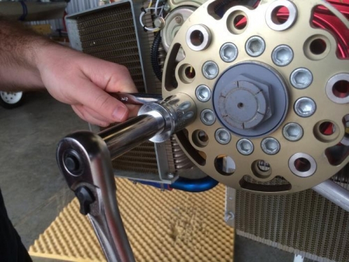

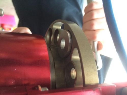

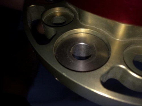

Press fitted the prop bushings into the prop flange of the engine. Used a 5/16" fully threaded 3" bolt and washer passed through the aft side of the bushing. The bolt was then passed through a socket that fit over the front of the engine prop flange hole. Then a pair of washers were installed under the nut that pulled the bushings into place as it was tightened.
