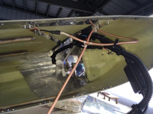

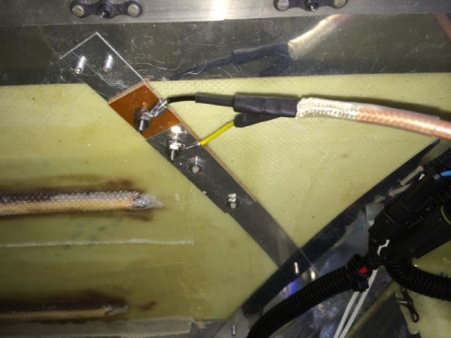

Brief Description:  Attached the Coax Cable to the Bob Archer Antenna
Attached the Coax Cable to the Bob Archer Antenna in the right wing. Crimped and soldered connectors for the attachment of the ground and signal posts. Secured the cable with a 6" loop forward of the connection to the antenna. The cable leaves the antenna at a 90 dree angle.
