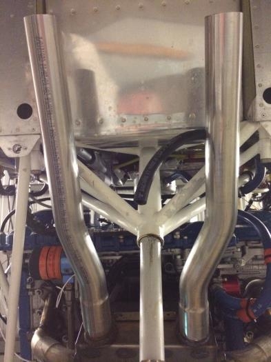

Brief Description:  Installed Tailpipes and Fabricated Muffler Brace

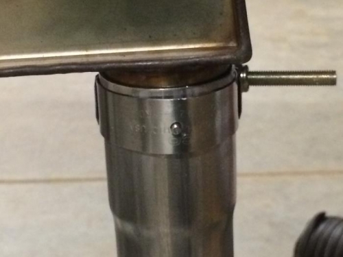

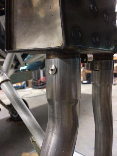

Installed Tailpipes and Fabricated Muffler Brace out of stock 1/2" steel. Bent to fit, drilled lightening holes, surface converted the steel and painted it. Used a Retention Pin that came with the engine for the left pipe but I improvised and used a clevis pin in the right pipe. Both pins are retained by the t-bolt pipe retention clamps over them.
Retention Pin
Retention Pin
Clamp Over Pin
Clamp Over Pin
