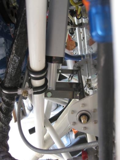

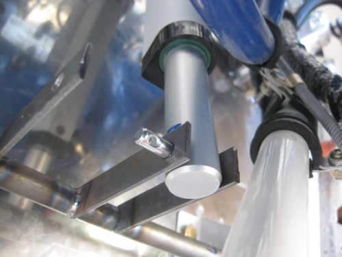

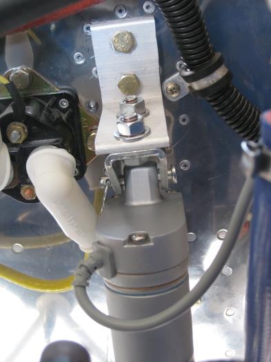

Brief Description:  Installed the Cowl Flap Linear Actuator
Installed the Cowl Flap Linear Actuator. Attached to the upper left side of the firewall. I used a piece of aluminum angle on the forward side and a riveted doubler plate on the aft side. Nutplates had been installed onthe doubler. Final installation will have clevis pins and locking wires installed to attach the actuator to the firewall and the lever arm.
