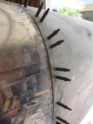

Brief Description:  Sanded the Cowling Level with the Firewall
Sanded the Cowling Level with the Firewall in the areas that were bulging yesterday. These areas had a inside glass buildup for the purpose of grinding the outer surface level with the firewall. There are two areas that will need more filling and grinding.
Bulges Before Sanding Level
