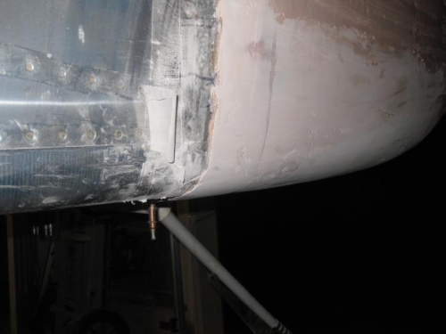

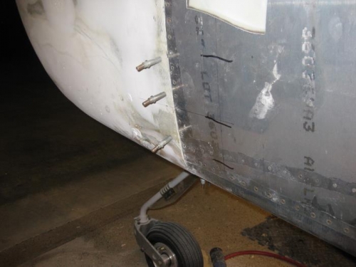

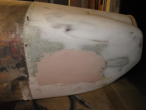

Brief Description:  Worked on the Fit on Both Side of the Cowling
Worked on the Fit on Both Side of the Cowling to the firewall. On the right side, micro and sanding several times. Micro was added to fill a depression in the side about midway forward since the lower corner repair.
The right side was close fit to the firewall. Some relatively minor re-working of the left lower corner is needed to improve the fit. A 3' glass strip was applied to a portion of the aft end of teh cowling to stiffen and buidup a weakened area after some re-fitting sanding. Some micro was added to the interior of this area so that the outside can be sanded inwasrd to change the shape of the cowling,
Right Lower Fit Improved
Left Lower Fit Improving
