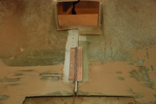

Brief Description:  Cut and Removed the Forward Half of the Hinge
Cut and Removed the Forward Half of the Hinge on the bottom midline of the bottom of the cowling. Will use the portion that is easy to insert the hinge pin. Ordered some Skybolt fasteners to attach the forward part of the bottom midline edges.
Applied 3 layers of glass to the bottom forward corners to fill thin glass application areas from the inside.
Cut Hinge
Cut Hinge
Hinges Pinned
Hinges Pinned
