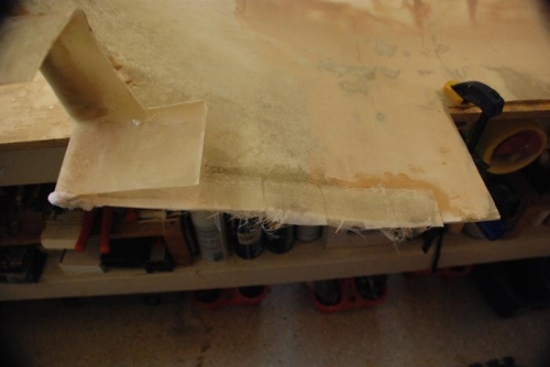

Brief Description: Sanded Hinge Edges While on the Aircraft
Sanded Hinge Edges While on the Aircraft.
Applied Flox mixture to fill the front edge of the oil cooler opening where the wooden dowel of the leading edge is visible.
Applied 5 layers of glass to the right side bottom of the cowling edge where the hinge will be installed. The area was significantly thinner than the left side and this area needs extra strength for the hinge installaton.
