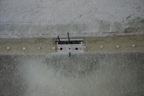

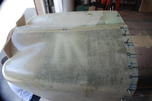

Riveted the Hinge Half to the Left Cowling Half Top. Before riveting the hinge, I installed a pair of #8 nutplates in the area where I had removed some eyelets from the hinge for the insetion of the hinge pins. The opening is about half way in the length of the hinge. A cover plate will be installed over the hinge pin insertion area.
Coverplate nutplates
Hinge Pin Insertion Lacation
