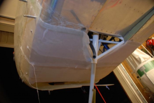

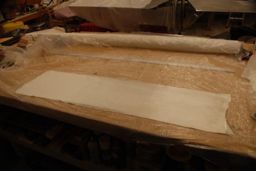

Made glass layup between plastic sheets. Resin squeeged into glass until transparent and excess resin is extracted. Cut off excess plastic, peeled one side of plastic off of glass, applied glass to destination, pulled off remaining palstic, applied dacron Peel Ply, worked out air, brushed epoxy over Peel Ply to insure wet layup.
