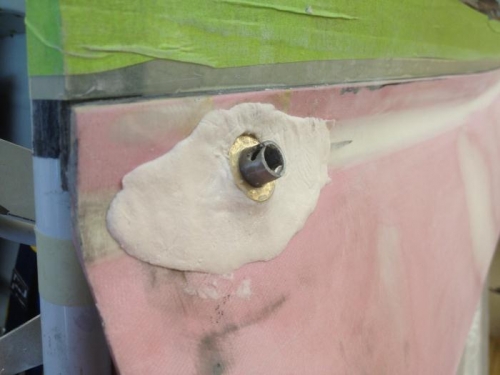

Brief Description:  Sanded the Handle Fiberglass Tube to Length
Sanded the Handle Fiberglass Tube to Length with the Brass Bushing in Place. Applied Epoxy/Micro/Flox around the handle bushing to mold around it. Mold release was applied to the bush to allow it to remain removable once to mixture hardens.
Applied a epoxy/micro/flox mixture to the bottom of the aft fairing to close a gap between the fairing and the aft top skin. Tape and car wax was applied to the top skin.
