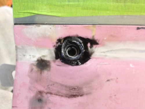

Brief Description:  Sanded the Right and Left Windscreen Transitions
Sanded the Right and Left Windscreen Transitions. Applied Black epoxy coat to the left side.
Sanded canopy skirt micro application applied yesterday to low spots.

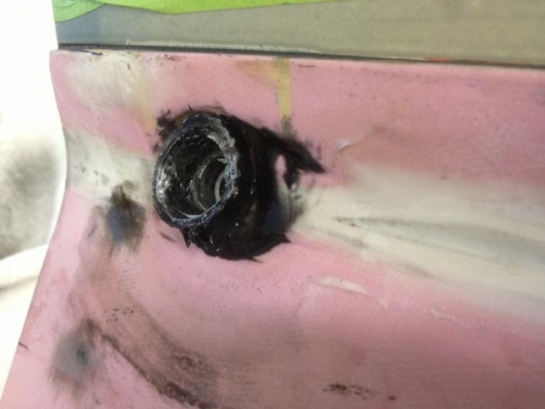

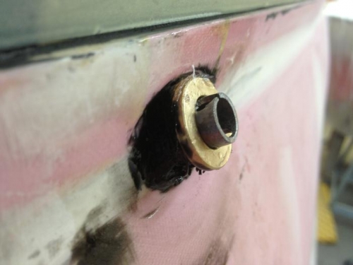

Wrapped fiberglass around an untrimmed bushing that was set in place on the Latch Handle shaft as it protrude from the skirt. The object is to form a tube around the bushing that will be later trimmed to the right length for the trimmed bushing. I will build up the area around the trimmed tube, while the bushing is held in place by the handle shaft, using a epoxy/micro/flox mixture. This mixture will be contoured once hard to form an esthetic transition of the fiberglass under the handle.
Fiberglass wrap w/o bushing
Bushing in place to form glass
