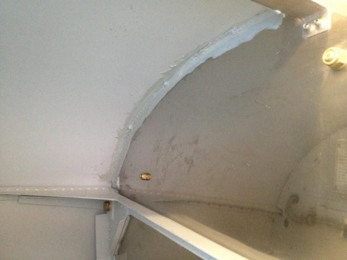

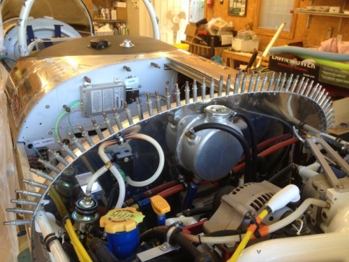

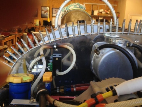

Fire Barrier Sealed Top Skin/Firewall Union. Along the far left side of the firewall. I applied a fillet of 3M Fire Barrier 2000 to the inside of Firewall/Top Skin Union. Otherwise, where I could, I applied the Barrier between the top skin and the firewall and clamped it with clecos.
Fire Barrier on the Right Side
Fire Barrier on the Left Side
Clecoed After Fire Barrier
