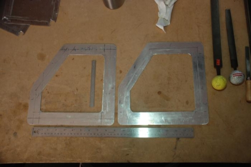

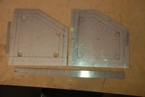

Brief Description:  Fabricated Reinforcement Ring for Access Panels
Fabricated Reinforcement Ring for Access Panels of the Avionics Bay. Used 0.032" T3 2024 sheet aluminum for the ring. I have 0.75" length for both the area to be riveted to the top skin as well as the area that will contain the nutplates for the access plates to attach.
