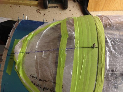

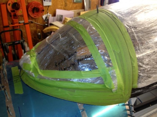

Brief Description:  Drilled a Positioning Hole In Top of the Windscree
Drilled a #40 Positioning Hole In Top of the Windscreen and the rollbar in order to be able to repeatably position the windscreen on the rollbar. I drilled the hole through a spacer to prevent the unsupported windscreen bending while clecoed in position.
Positioning Cleco
Positioning Cleco
Positioning Cleco
Positioning Cleco
