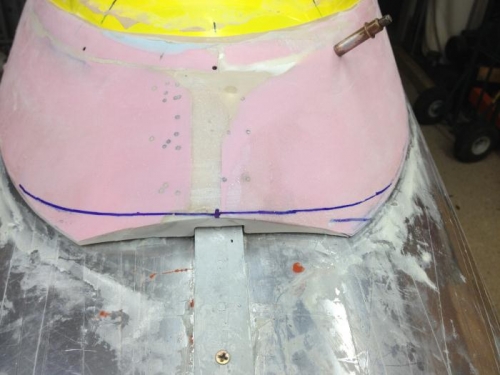

Brief Description:  Sanded the Aft Canopy Skirt
Sanded the Aft Canopy Skirt. Applied micro to the transitional areas on the sides where the skirt needs to change from the profile of the side skirt to the aft skirt. The aft skirt is showing filler that was applied to the interior of the skirts. This thin area will need to be glassed for strength.
