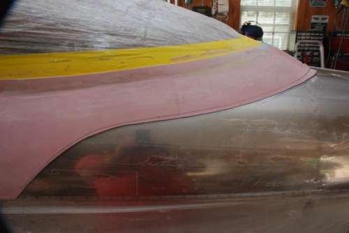

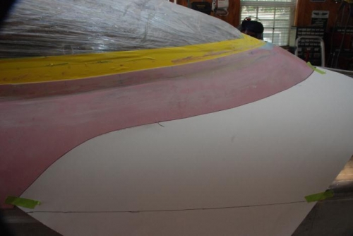

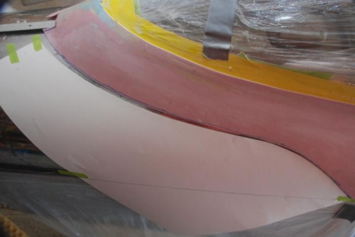

Cut Posterboard Contours of Each Skirt Aft End. Once I had the contour shapes of each skirt aft end, I was able to flip the contours over and apply each one to its counterpart side and compare the differences. The right skirt is cut higher than the left skirt, therefore, the left skirt will get the most reshaping. A line was traced onto the left skirt as a guide for the reshaping. The Left Contour will remain on the Right Skirt as a reference.
Rt Contour on the Lt Side Skirt
Trim Line Drawn on the Lt Skirt
Lt Contour on the Rt Skirt
