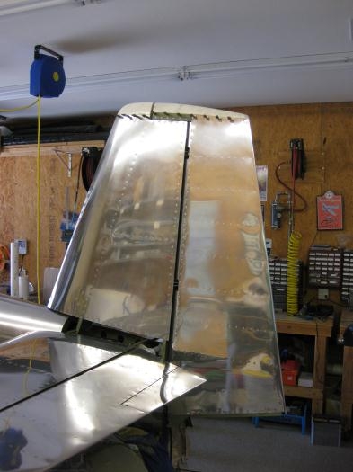

Brief Description:  Adjusted the Rudder Alignment with Top Fairings

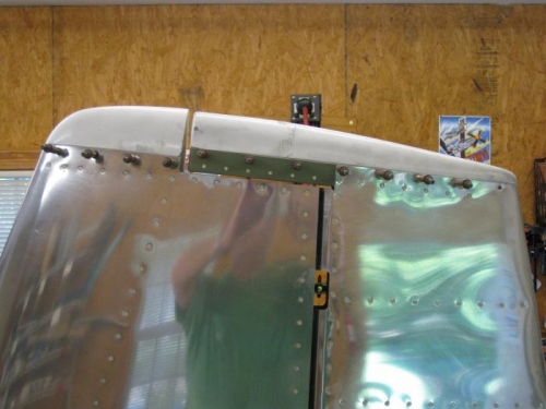

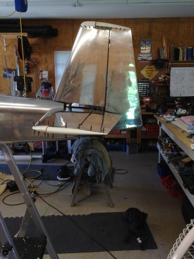

Adjusted the Rudder Alignment with Top Fairings of the Rudder and the Vertical Stabilizer. This required multiple attachments and removals as the rod bearings were adjusted to get the current alignment. Though not perfect, it is much better now. The top of the Vertical Stabilizer now aligns with the Rudder's counterbalance arm and there is a 1/4" gap between the Rudder Arm and the Vertical Stabilizer Fairing. I plan to make any further adjustments in the fairings' alignment using composite materials.
Even Spacing and 1/4
Even Spacing and 1/4" Gap
