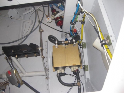

Brief Description:  Fabricated a Connection from Pre-Filter to Pumps

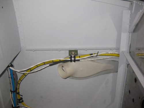

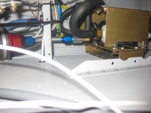

Fabricated a Connection from Pre-Filter to Pumps on the first try. This is definitely an example of succes after frustration cured through separation. I managed to complete the fuel pumps installation and securing the Starter Cable in the area of the pumps. To do this, I fabricated some angles with nutplates and riveted them to the longerons in the area. The Fuel pump wires were also attached and secured with adel clamps. The fuel pump grounds still need to be attached to either the Forrest of Tabs that will be mounted on the firewall or I may simply attach the grounds directly to the firewall near the pumps. This will reduce the wire run and yet still I'll be attaching the ground wires to the same common structure as the Forrest of Tabs.
Filter to Pumps Connection
Fuel Pumps Installed and Wired
Securing Fat Cable
Securing Fat Cable
