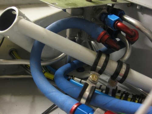

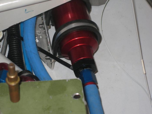

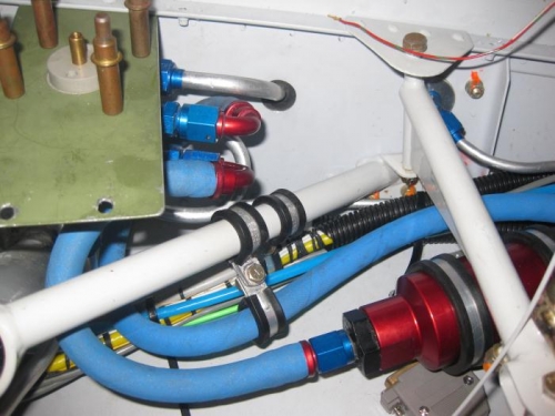

Brief Description:  Installed Hoses for the Andair Valve Outlet and In
Installed Hoses for the Andair Fuel Valve Outlet and Inlet. Aeroquip Socketless fittings and hole were used. The hose is good up to 250 psi and fittings are pushed onto the hose until the hose bottoms out on the fitting. The Straight connectors went on fairly easily but the curves fittings were much more difficult to install for lack of a good means of securing the fitting while forcing the hose (pushing) into place. The curved fittings rotated and decreased the effectiveness of efforts to advance the hose onto the fitting. Adel clamps were installed to secure the Fuel Return Line to the lannding gear weldment. The supply line seems to be stiff and secure as it goes to the filter.
Return Top, Supply Bottom
Adel Clamps on Return Line
Filter's Mount and 3/8
Filter's Mount and 3/8" Fittings
