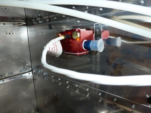

Brief Description:  install fuel sensor
Manual 28-05 finish step 1 - install fuel sensor onto fuselage. Torque rear bolt only with washer to 85 inlb, add torque seal.
Remove two fuel lines already fabricated and installed. Will redo them because I did not deburr the inside of the tube at the cut before flaring. Saw this when watched the HomeBuiltHelp video demonstrating the tubing fabrication. Ordered new alum tube and fittings.
