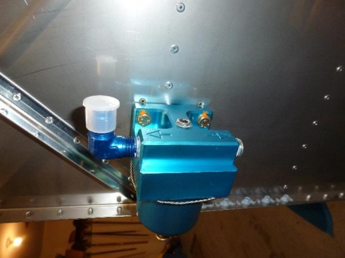

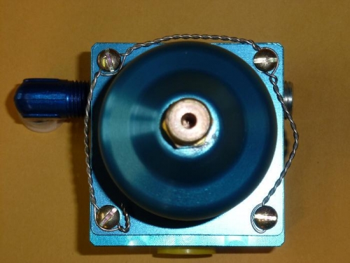

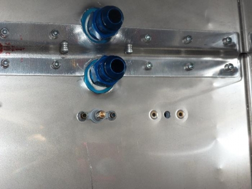

Brief Description:  safety wire and install gascolator
Manual 28-05 step 2, 3 - safety wire the gascolator, install gascolator onto the fuselage, install fitting. Used Loctite 567 on fitting. Did not torque the mounting screws due to no clearance to use torque wrench. Did apply torque seal for visual reference of the screws in the same position.
Also tried deburring the inside of the alum tubing. Cut several times and tested to see how flare worked etc.
