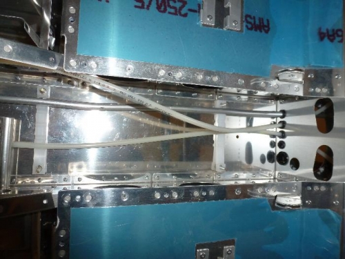

Manual 28-04 steps 1 - 5, fabricate F-1259E pump to shut off valve fuel line. Had difficult time running the line through the second hole grommet. Had to sand the inside of the grommet some. May have to tweak the line a bit near the shut off valve when installing the fuselage clamps for proper fit.

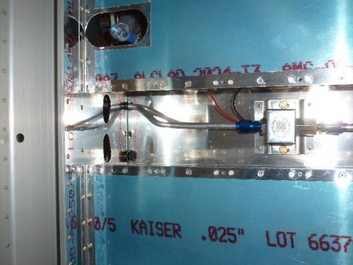

ouy going fuel line at pump
pump to valve fuel line via fuse

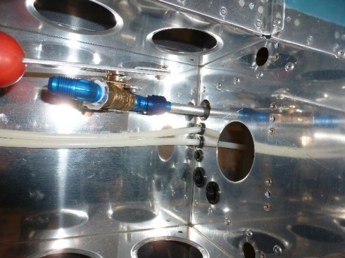

fuel line in at fuel shut off valve
