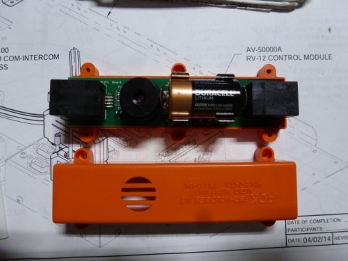

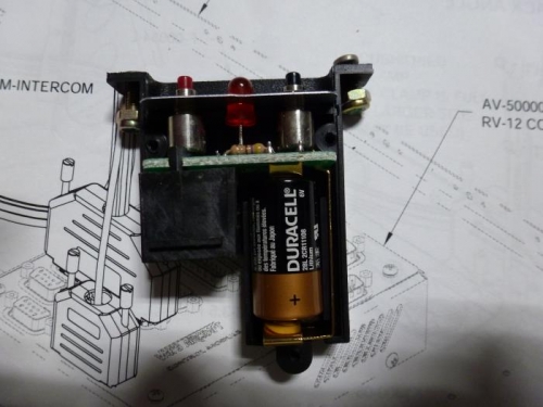

Installed and connected the ELT , installed batteries in the remote and audio announcer. ELT remote gave an error code when connected, will change to reversing cable to test. Installed antenna as well, cut away some of the wrap on the antenna mount to insure ground conection to the antenna.

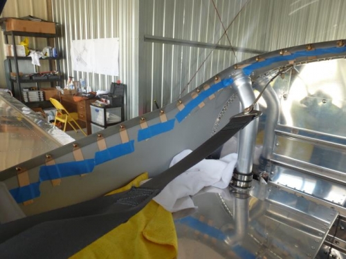

Finished putting in the tongue depressors between the turtle deck skins and the rear window to create a gap for the sealant.
ELT remote battery
ELT remote battery
ELT audio battery
ELT audio battery
rear window gap
rear window gap
