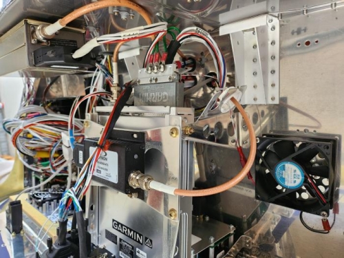

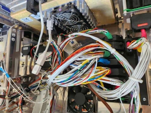

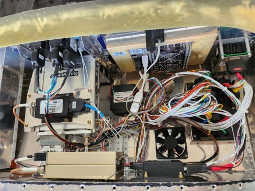

Brief Description:  cleanup wiring in instrument bay
Opened the electrical bay, affixed the dimmer knob label, mounted the ELT remote. Found a wiring issue with the xponder 25 pin connector when it was wiggled. The pin for the red power wire was not completely inserted into the connector. Corrcted it (lucky find).
Added wire-ties as needed to cleanup the wiring. Added RTV in a couple spots to avoid damage to wiring.
Applied RTV to the back of the glove box to hold it without vibration.
Tightened all of the wiring connectors. A couple were somewhat loose.
